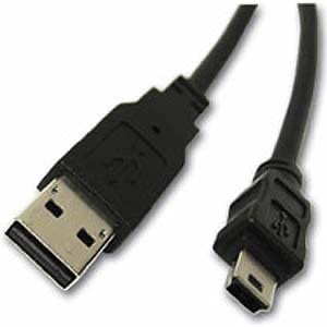

cabel flash for dreambox and driver for cable CP210x_VCP_Win_XP_S2K3_Vista_7.zip

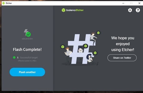

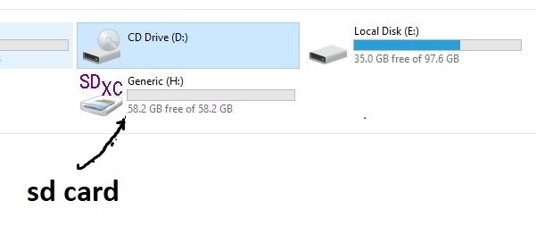

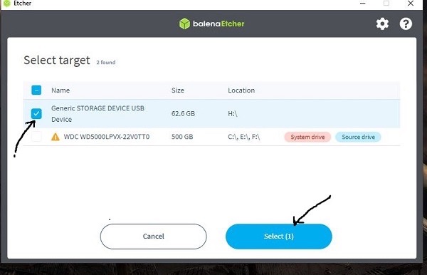

1:Transfer bootloader file to sd card using computer
https://www.mediafire.com/file/9d7lb8to ... r.rar/file
Download the sdcard.bin file and then burn it to the sd card with the balenaEtcher program.

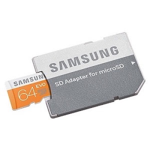

Note if the program does not accept the choice of the memory card placed in the holder
... we will change the holder to another whose shape resembles a flash disk
And we put the memory card on it...... and when the burning is complete, we return it to the first holder to put it in the receiver

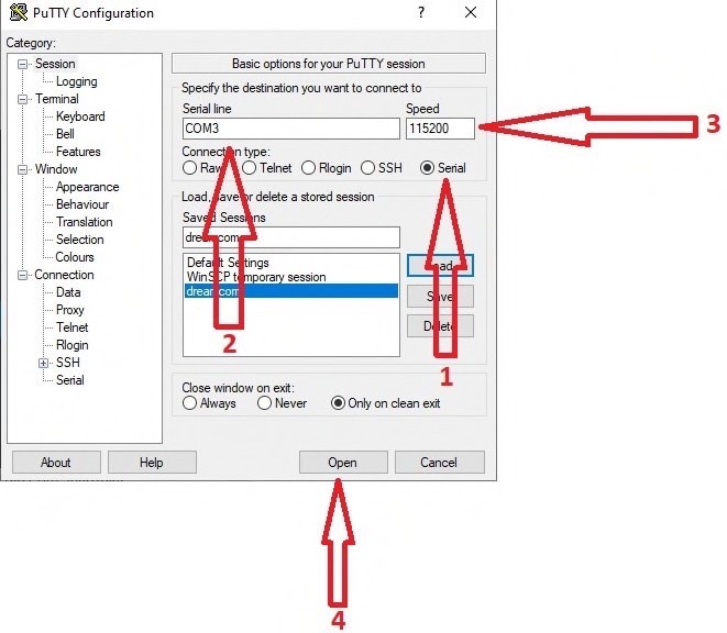

* We open the Putty program and specify the settings as shown in the picture
serial
com
11520
open

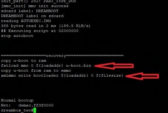

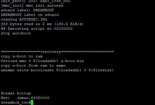

Wait for the Putty program to read the receiver, as in the picture below
the line dreambox_two # enter the two commands in the order, after entering them press
return:
1. fatload mmc 0 ${loadaddr} u-boot.bin (click return)
2. amlmmc write bootloader ${loadaddr} 0 ${filesize} (click return)
Finally, remove the sd card from the reciever
and reboot it and flash it in the normal way in the browser
